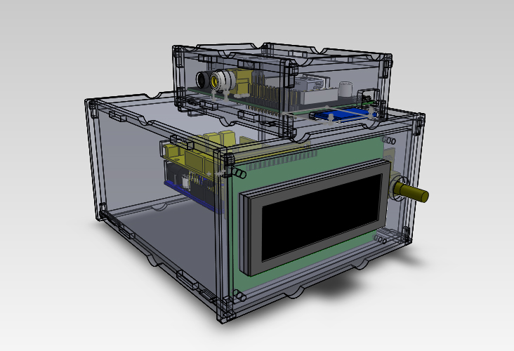

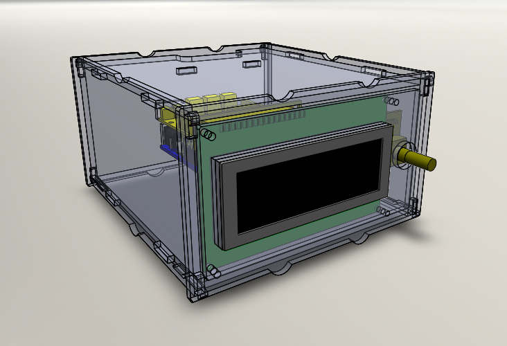

The BrewPi Case
The design of the BrewPi Case was inspired by the raspberry pi case by Adafruit. Apart from its stunning ability to hold a BrewPi, we tried to incorporate some aspects into the design:
– Stackable; not only with itself but also with a case for the Raspberry Pi. This means that in (the extremely rare) case you are not brewing beer you can use the Pi and its casing for other cool projects.
– Non-glue! Say no to the sticky stuff and save your skin, because this case is fitted with fancy snap joints, which means you can also open it up easily.
– Access. Apart from being able to access all the ports on your Arduino and Raspberry Pi you can also access BrewPi’s screw terminals.
– Transparency… Here at ‘Van Alles Wat’ we are all about transparency, this is why the case will be produced in 3mm thick, transparent acrylic. Besides being able to watch the electronics work their magic it’s also great for hygiene.
Front perspective view of the BrewPi Case
Rear perspective view of the BrewPi Case
BrewPi case with a raspberry case stacked on top

  2. Zigurana on February 6, 2013 at 11:03
    Hi!
    Was this case intended to hold the SSRs and/or other heat producing components?
    • Koen & Gijs | Van Alles Wat Ontwerp on February 6, 2013 at 18:54
      Now that you mention it… we’ll definitely discuss this with Elco in our next BrewPi meeting. There is still some space in the case that could be used for this purpose.
      We’d also have to look at how much heat will be produced by the SSR in that case, the other elements don’t heat up that much.
